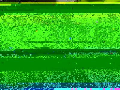

5998 Tung-Sol with 6SN7 Electro-Harmonix, outstanding bass with the 6SN7, speedball upgrade, as well as locking Neutrik jack, Axon True output caps, Alps Blue Velvet, pilot light, amazing sound coming out of my HD - 600`s.

You kept the finish simple, I like it.  Looks alot like mine :-)   http://www.bottlehead.com/smf/index.php/topic,2188.0.html
I was using a 6SN7 with adapter as well.  I liked it.  I built Foreplay III with 6SN7's and figured I would end up with the 12AU7 back in Crack afterwards.  I have been favoring 12BH7's instead.  But if Crack was all by itself again, I'd be using a 6SN7.  What 6SN7 tube is that, is it a Tungsol? ... Nevermind, missed the EH 6SN7 part :-)

Looks great!  But what's the little blue thing between the jack and the input tube?
Looks like a LED to me.

Thats a blue led pilot light.
