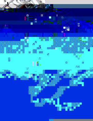

« Reply #2 on: April 03, 2010, 05:46:14 PM » |
Some pictures of my quickie...

« Reply #4 on: April 03, 2010, 06:47:44 PM » |
Thanks for the feedback. Attached is a close-up of my homemade dampers. I like to refer to this DIY project as a "tube job". Maybe that could be a future name of a tbd product (hopefully a dac of some sort).

I hadn't even noticed the tube dampers in the smaller pictures even thought you had described them well. They look nice and I would consider them a good heat sink to help keep the tubes cool for a longer life.
